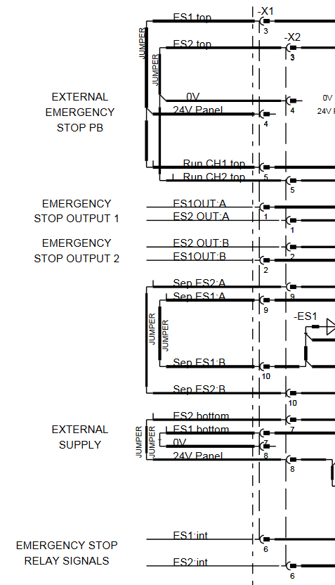

Another thing you can check are the run chain contacts. These contacts are located on connector X1 pin 5 (Run CH1 top) and X2 pin 5 (Run CH2 top). X1:5 expects 24VDC and X2:5 expects 0VDC. The connectors are explained here: ABB Emergency Stop conflict (error 20223) - #2 by 4lloyd. There should be a jumper cable between X1:4 and X1:5, and between X2:4 and X2:5 from the factory as seen in the picture below.
It may be that the jumper is removed and that the contacts are connected to something else. Can you tell me if the jumper cable is in place or that it’s connected to something else?
